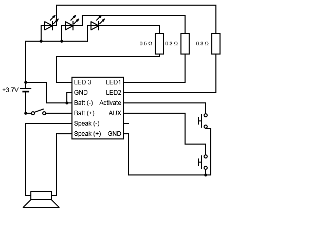

I needed to decide on the resistors used to stop the LEDs going nuts, getting hot and draining the battery too quickly.
I was going for a BBW Tri-Cree which had the following specs.
2 x Blue LED – 3.4 Volts at 1000ma
1 x White LED – 3.15 Volts at 1000ma
Blue
(3.7-3.4)/1 = 0.3 Ohms
(3.7-3.4)*1=0.3W
White
(3.7-3.15)/1 = 0.55 Ohms
(3.7-3.15) *1 = 0.55W
So I ordered the resistors from RS.
The saber armoury provided a 2W VECO speaker, the 3D print files for the 89Sabers OWK4 chassis, Tricree (BBW), optic, heatsink, Optic holder, battery holder and kill switch .

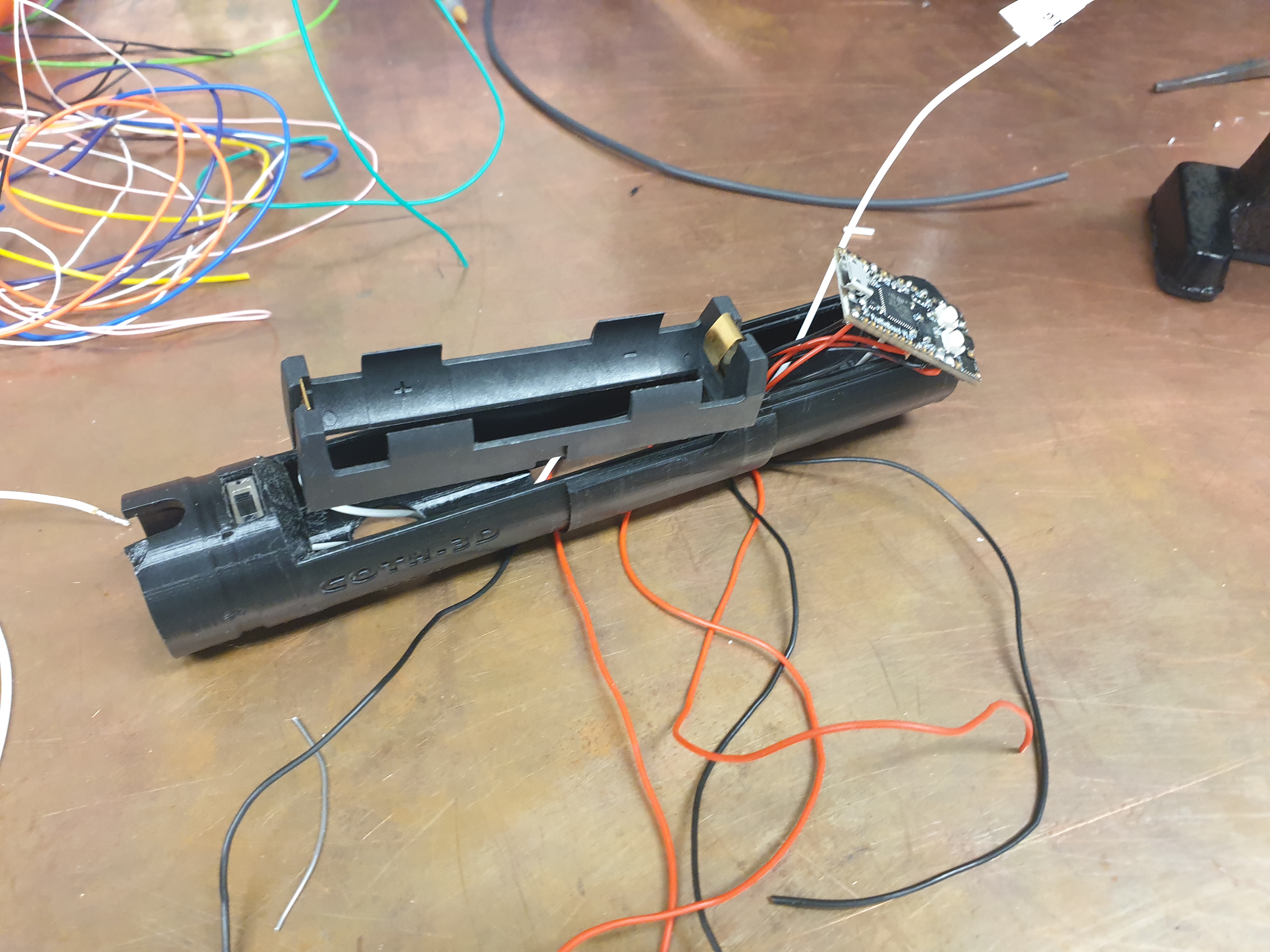

The OWK4 comes apart into handy sections and with the chassis printed - I soldered wires onto the battery holder

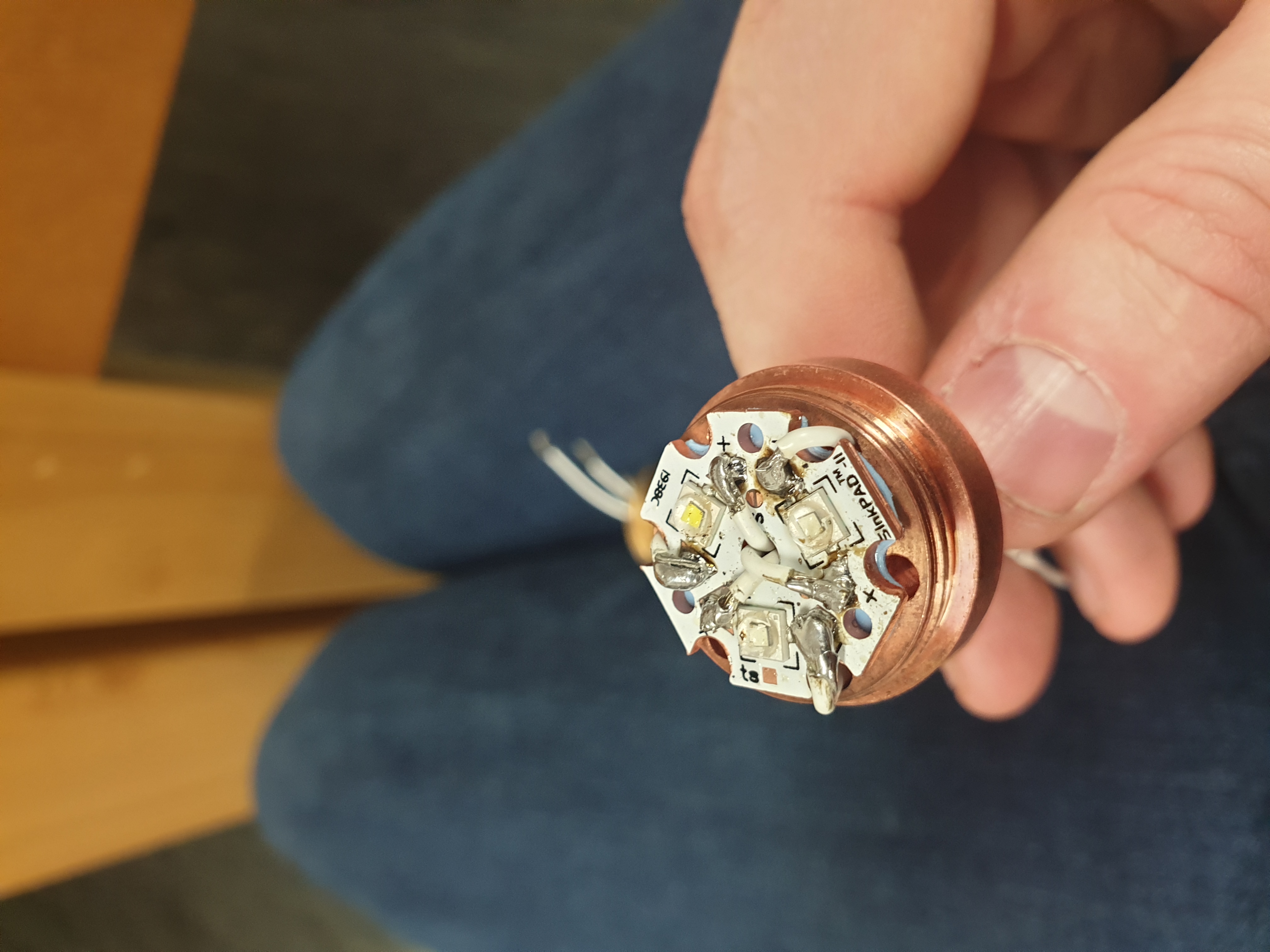

bridged the LED pads on the star

By unrusting my solder skills on the other parts - i started on the (TINY) Proffieboard, as this was only an in hilt LED setup - I didn’t have to use most of the connections on the board.
I applied solder to each point on the board, tinned the tiny wires and melted the solder enough to push the wire through the holes on the board. I used my DMM to ensure good connection on all joints.
Thankfully - I did most of this at work - so I had a Variable DC source to check the LEDs. It looks messy as hell, but seems solid enough.
With the speakers, battery, LEDs and board largely soldered - then came the fun part of threading everything through the chassis and making connection. As I still had no resistors, I left them out and would add them in later.

Firstly, using the emitter as a heatsink works, but it can only take so long being powered before the heat becomes an issue - I ended up frying part of the LED (after installing my resistors) - so I ordered a new one and then had to come up with a solution to incorporate a heatsink.
I had an old 7/8" heatsink and LED holder - So i had to dremel the edges of the LED to allow it to fit in the holder but that allowed it to have a mounted heatsink and ample thermal paste.
